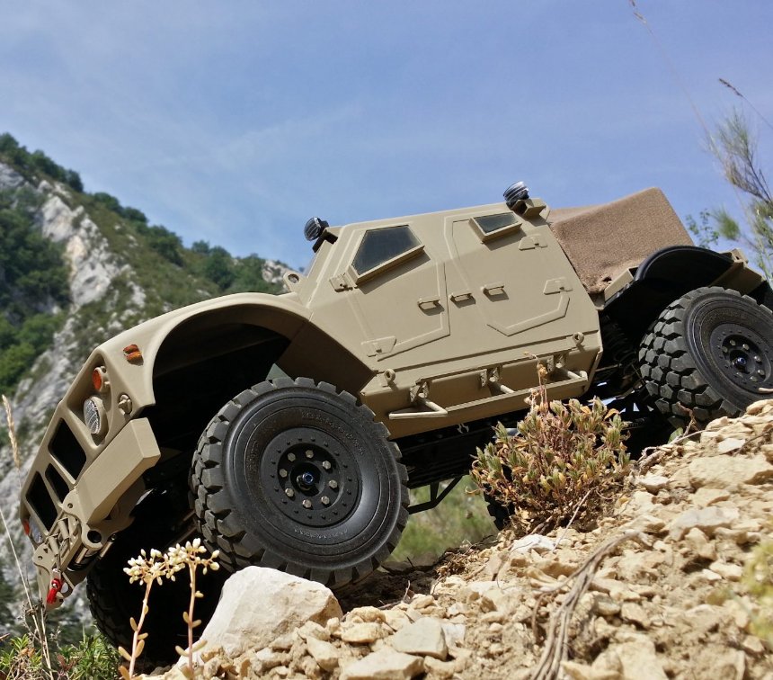

Nieuwe optie gevonden op basis van Axial SCX10 chassis.
OSHKOSH-MATV
https://3dlabprint.com/shop/oshkosh/
OSHKOSH-MATV

OshKosh! Oh yeah! #wannahave
