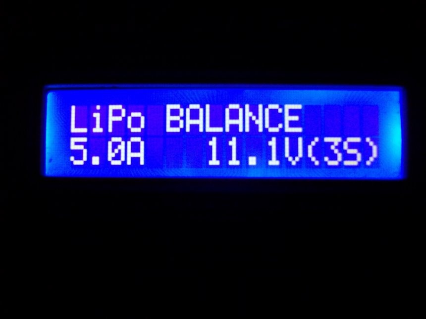

Dan heb je de "balance charge" deze gebruik ik altijd gebalanceerd laden zodat alle celspanningen gelijk zijn.
Maar mijn lader heeft nog twee laad standen waar en wanneer gebruik je deze en wat is het verschil en of voor en nadelen?

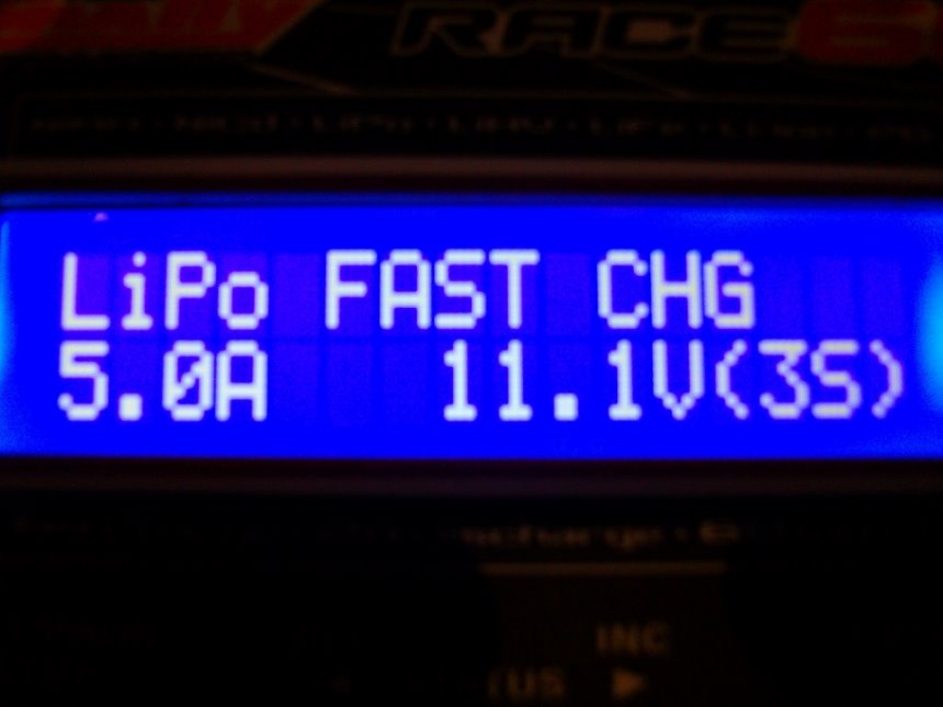

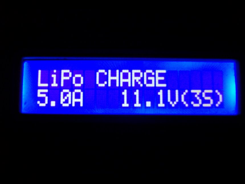

Met name het verschil ook tussen lipo "charge" en lipo "fast charge"

Fast Charge: This mode tells the charger to only complete the first phase, constant current (CC) charging. The charger applies a high enough voltage to cause current to flow into the pack, up to the max current you've set. This gets the pack mostly charged, (70-80%) but the battery can still take more. Note, this fast charge mode has nothing to do with the charge rate, as that parameter can be set for any mode, and should be set based on your lipo, or at 1C if not specified. Fast charge merely tells the charger not to go on to the next (slower) charge phase, which brings us to:
normal charge
Normal Charge: This mode starts off like the fast charge, but after the cells reach 4.2V (or preset value) the charger switches into the constant voltage (CV) phase. In this phase the charger applies 4.2V to each cell and holds it there, while monitoring current flowing into the pack. This 20-30% capacity from the CV process can add quite a bit to the overall charge time, and actually increases if you used a high charge current in the first CC phase. Eventually the amount of current flowing into the battery drops lower and lower until the pack is considered "charged" and the charger stops completely. The LiPo can be considered fully charged at this point.
Balance Charge: Finally, you may optionally choose to perform a balance charge if your charger supports it. This mode is similar to a normal charge, except that a small load is placed between each individual cell and is used to bleed off or equalize the voltages between these cells. This helps ensure one cell (with slightly higher voltage) isn't doing more/less work than the others, and thus dying faster than the rest of the cells. It is a good idea to perform a balance charge regularly if you want to extend the life of your lipo packs.

Maar bij lipo charge wordt er normaal geladen en zakt de laadspanning naarmate de lipo voller wordt, maar worden de cellen alleen niet gebalanceerd.
Bij lipo fast charge blijft hij laden met de ingestelde laadspanning.

Bij 'fast charge' laad de batterij daarom niet helemaal volledig op. De lader slaat iets eerder af. Het laatste beetje kost nou eenmaal meer tijd vanwege een lagere laadstroom.

Hoi Leyhon om het simpel te houden als je fast charge gebruikt laad je snel op zonder balanceren
Dit word meestal in de racerij gedaan tussen twee stints dor
Word wel dor de fabrikanten afgeraden

[mention]Mud monkey[/mention] dat charge dan de balanceerfunctie niet gebruikt is aannemelijk.
Maar wat is er verschillend tussen "charge" en "fast charge"?

Het verschil tussen charge en fast charge is dat bij de fast hij snel op max de amps er in perst
Hoe meer cellen des te groter het verschil
