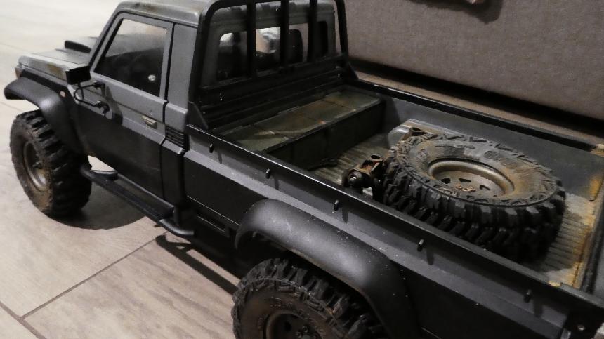

This is the car that has arrived

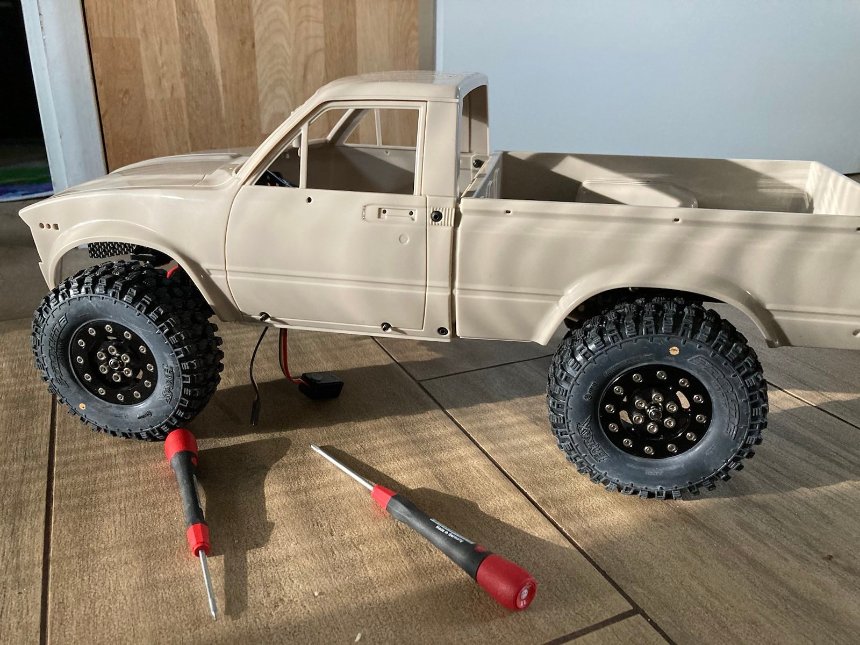

And here we have the sister bodysuit of the YJ
And without great efforts, just as I had planned, the axles above the leaf springs but turned around, not as I had them, I removed the two-speed box and the transfer with that protruding belly and I put in an hpi with a central transfer in the purest rcmodelex style , all the weight will be lower and the flat belly should come as standard with this car, 2300 combo and mob servo

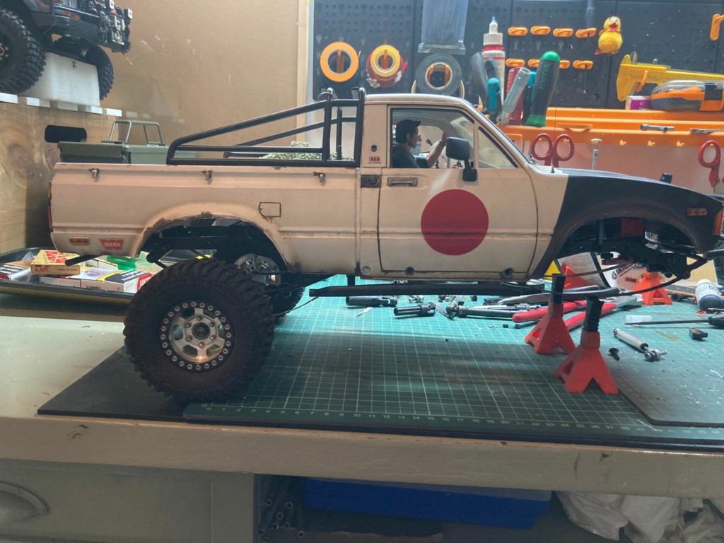

And here with his brother ready for action

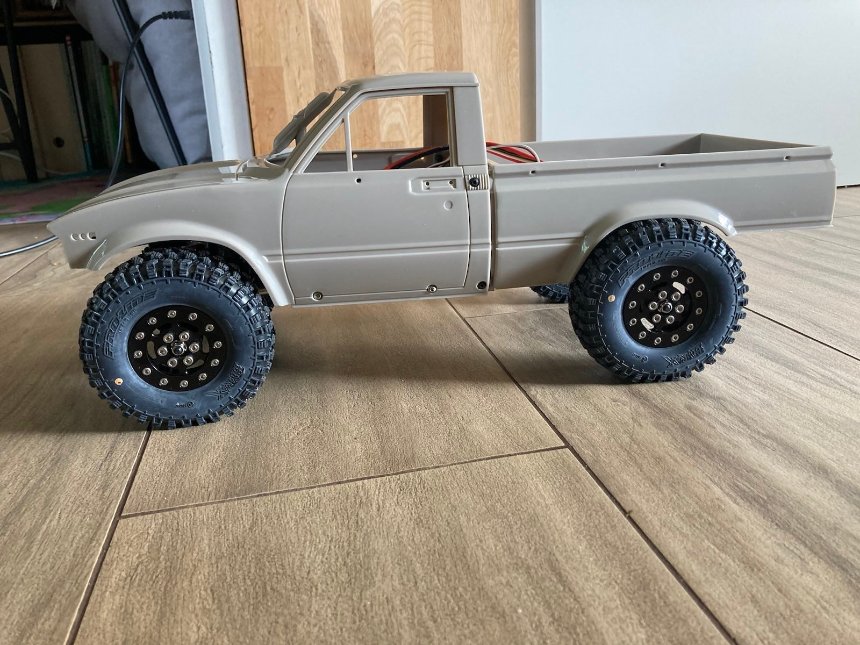

Yesterday I just assembled and tested and it can't be, it is very very high at the front and I can't go down any further since the differential doesn't allow it and if I put the leaf spring below the axle, the third link support hits the chassis rails, so play links in front and leaf spring in back
Here you need to adjust the back, but in the front that will be the final height

You might be able to drop the body on the chassis. As I can see your bed has still a lot of room to drop.

I already thought about it, resting the body on the chassis, that's how I have mounted on others, but in this chassis, the lipo doesn't fit if I do that with the interior and the hpi in front

In the end it will go with links at the front and leaf springs at the back, I will be able to have a lower height, so it will also stay with the 100mm wheels
I have finally managed to adjust it at the front... in the end 100 tires hehehehe, let's see if in the next few days I finish with the rear part and put the winch on the bumper, in addition to probably putting some smaller headlights on the bumper
