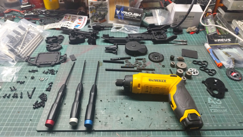

New project start

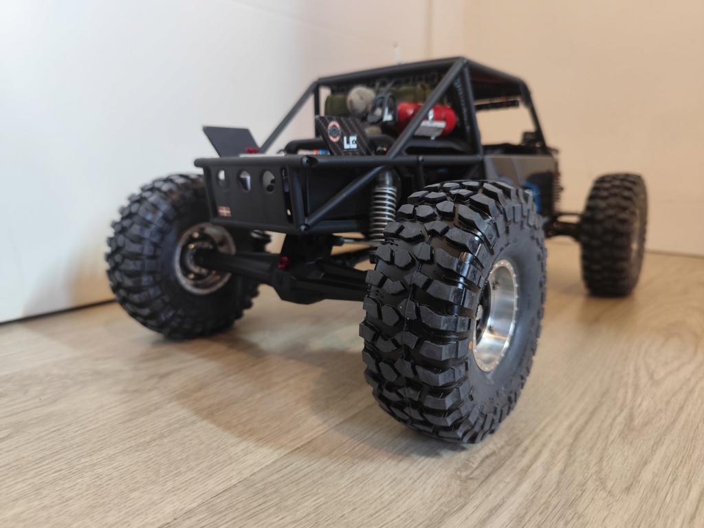

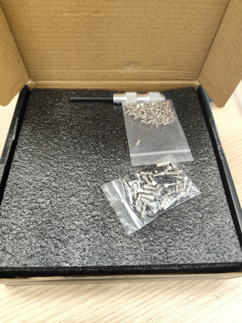

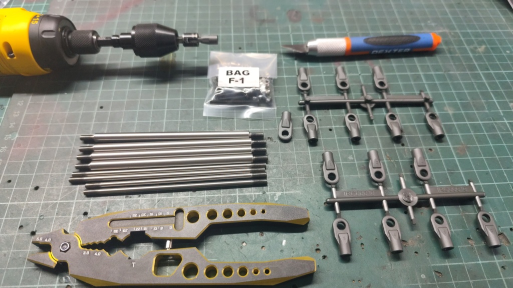

more arrived parts , happy weekend !!
That for the moment , and waiting for :

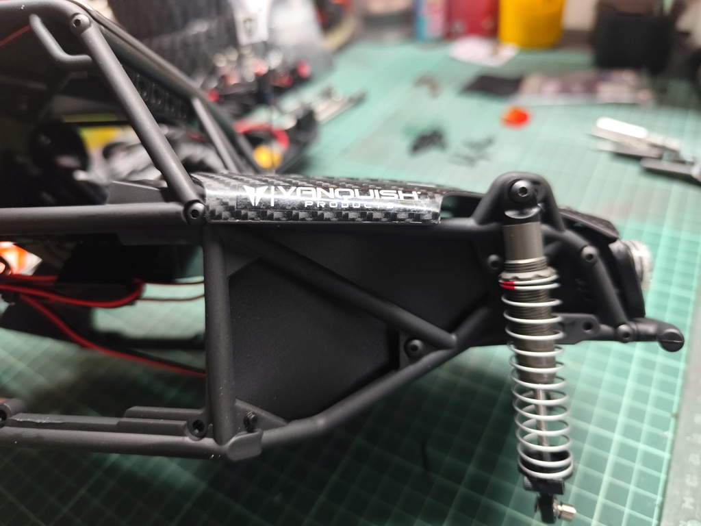

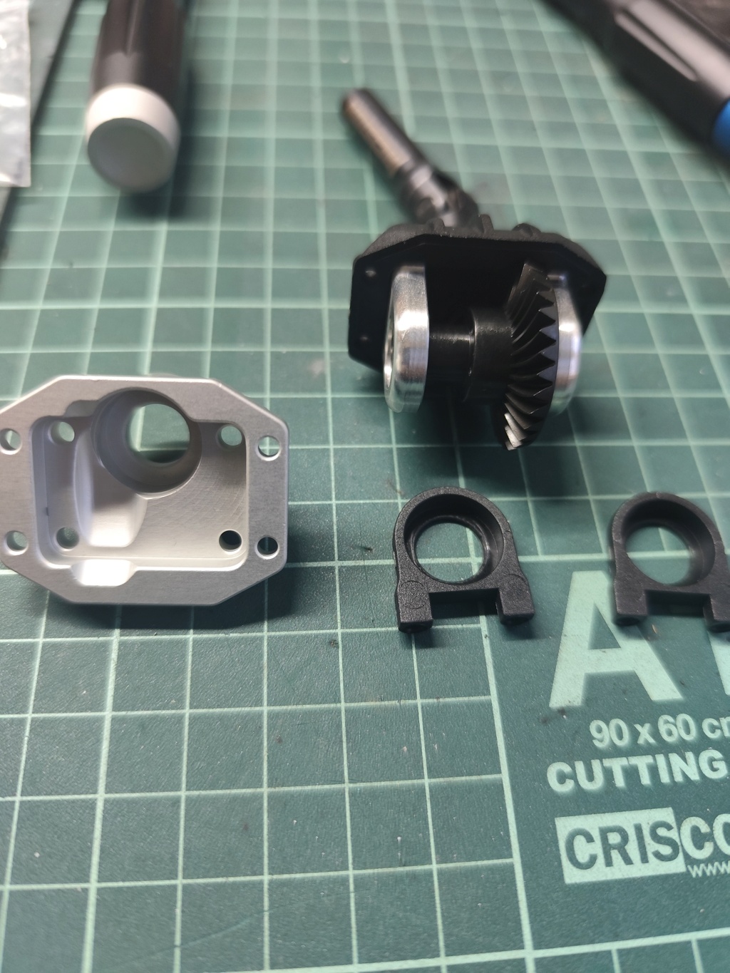

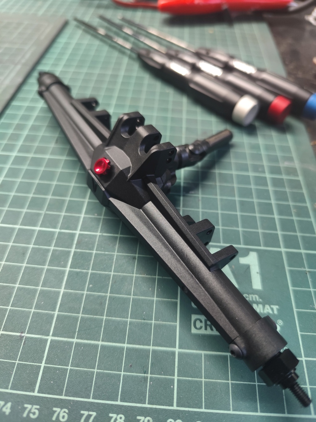

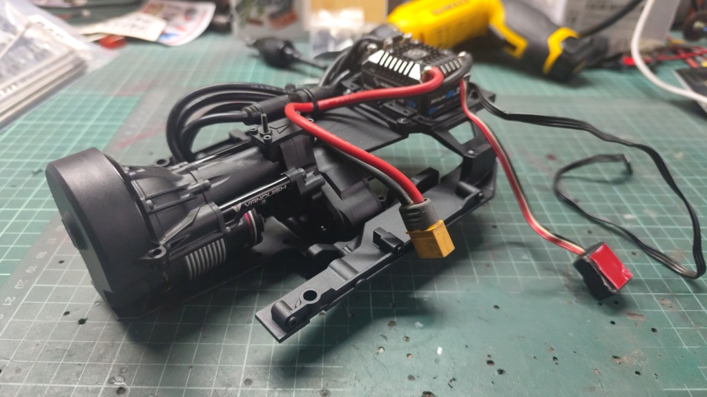

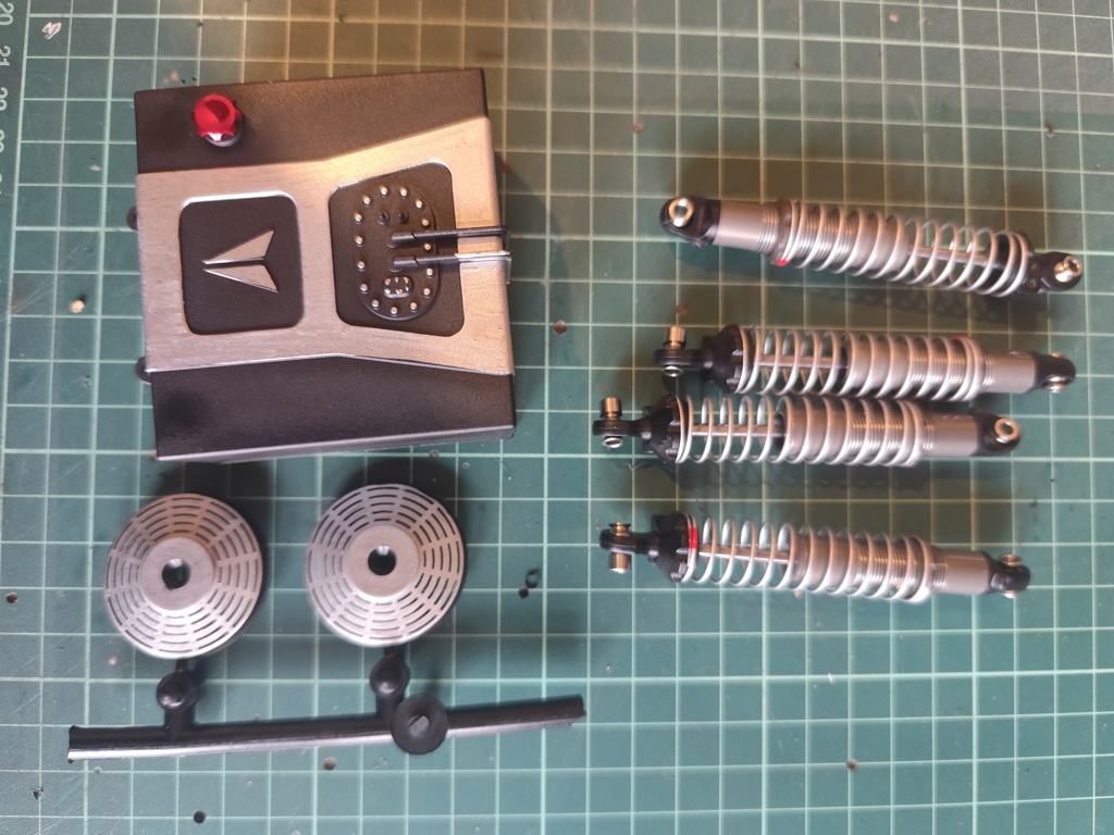

A productive morning, tranny mounted with the overdrive and a screw to simulate the gear shift lever :

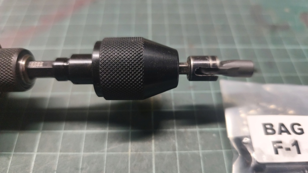

Then the links, I I have made a support with an old joint so that I can screw the ball joints in faster and without suffering hahaha and everything is placed in the support of the tranny

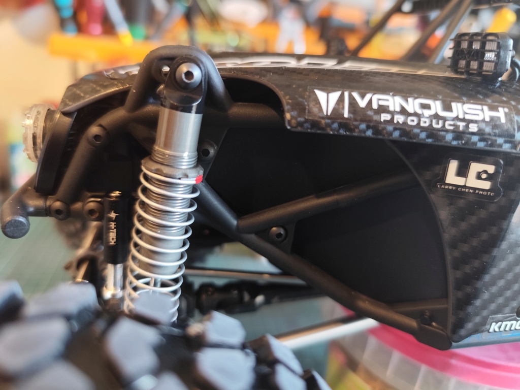

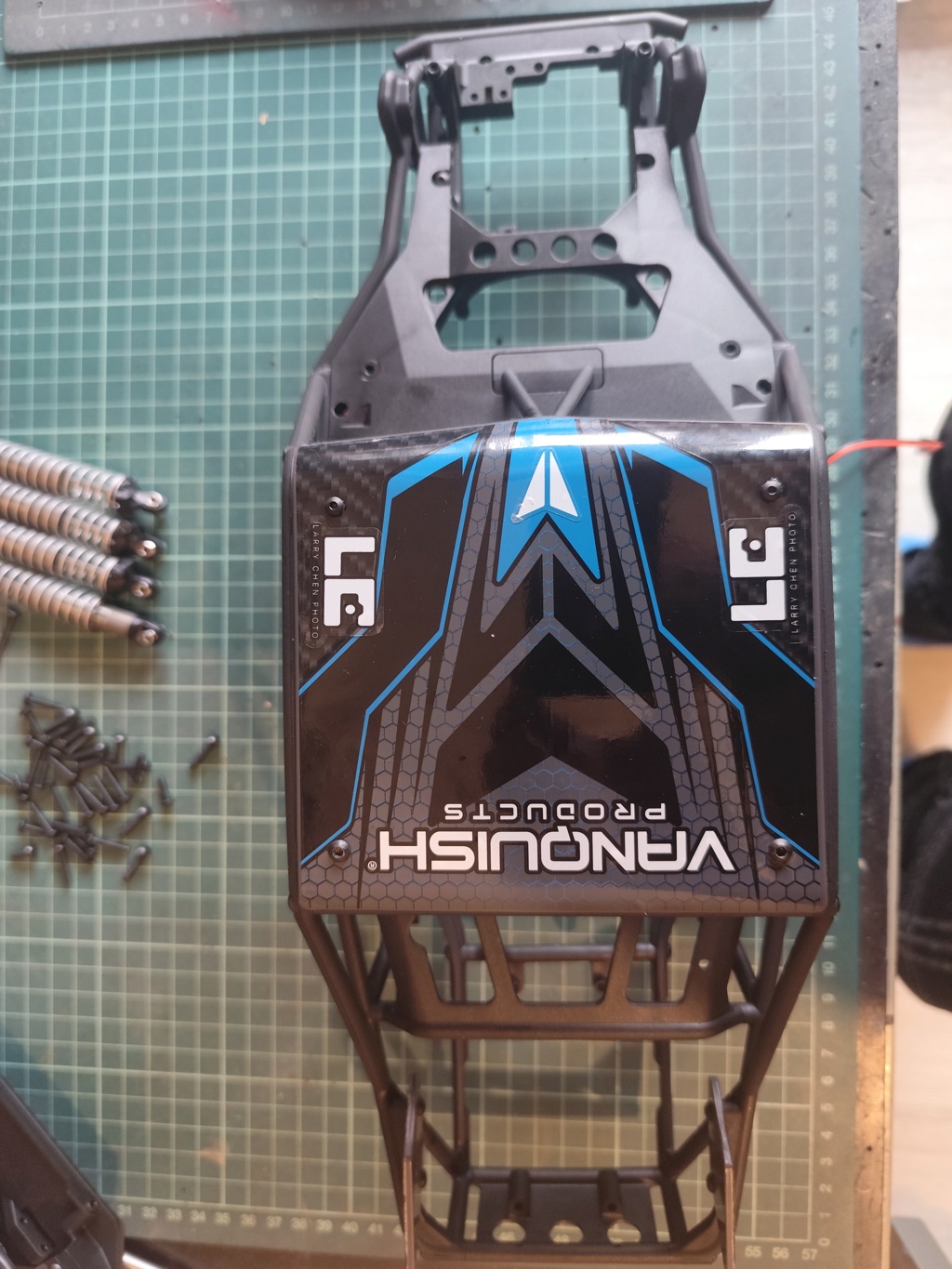

I have also mounted the shock absorbers with 650w front and 900w rear, and I have made some progress with the paint and bodywork issue
and up to here all the work of the sunday

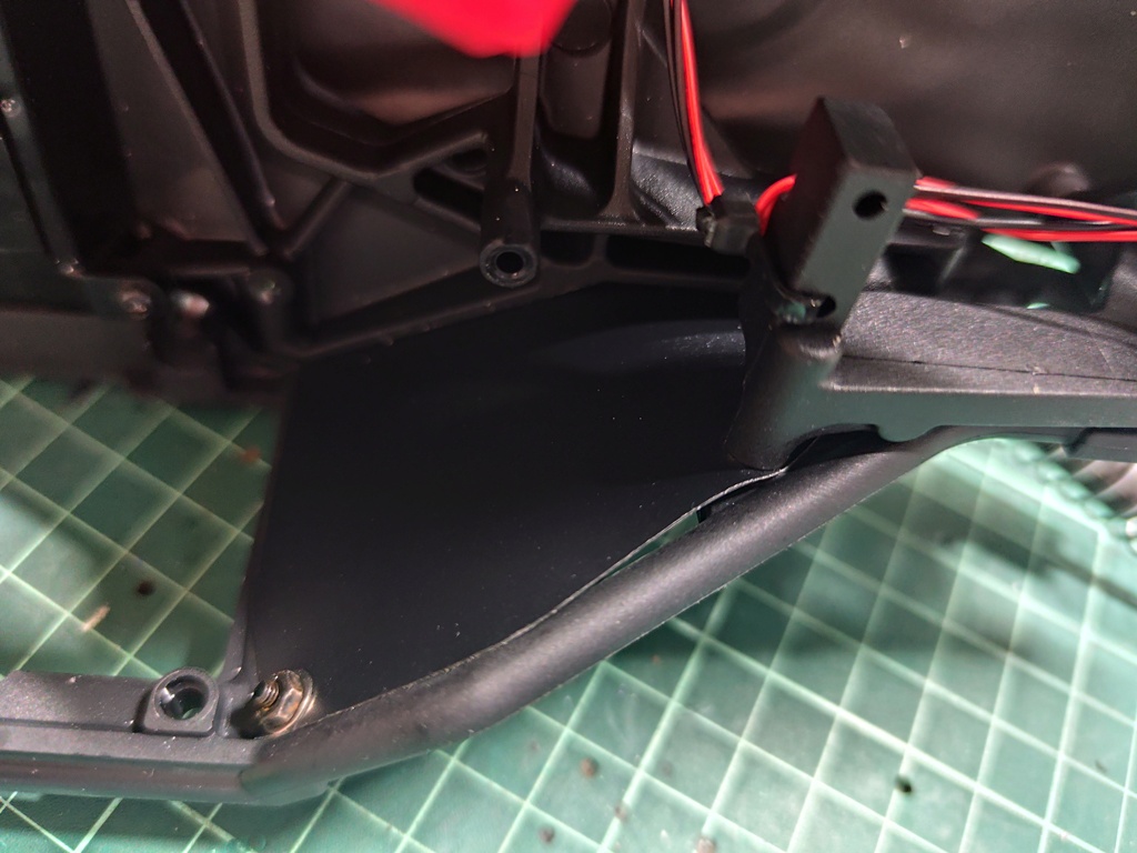

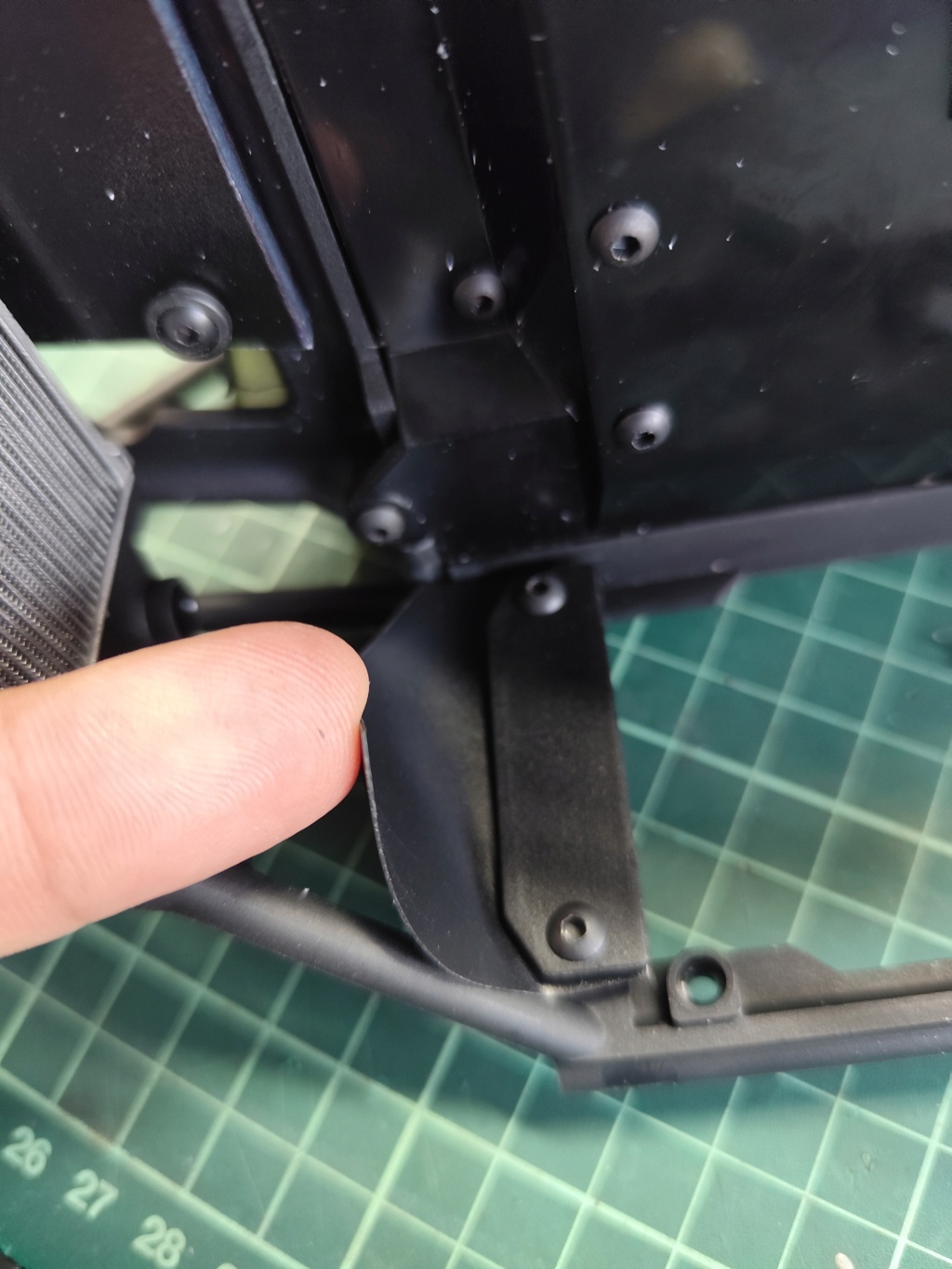

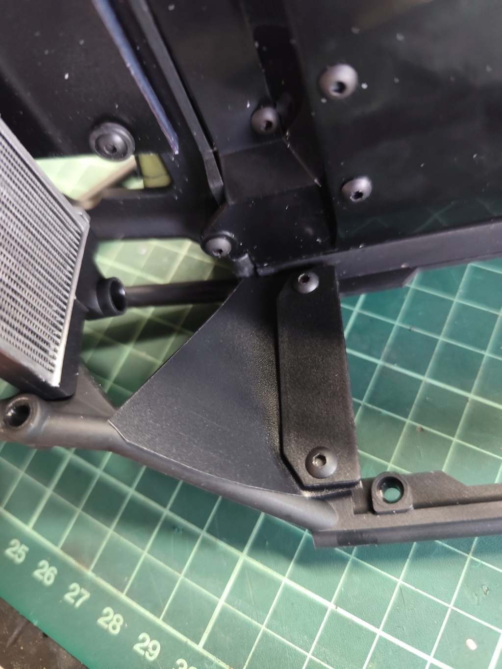

Today work , small cover for some chasis holes , 1€ and some work

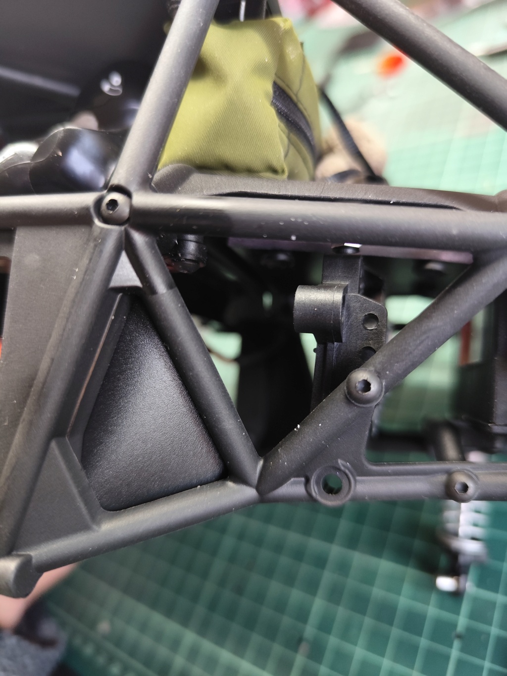

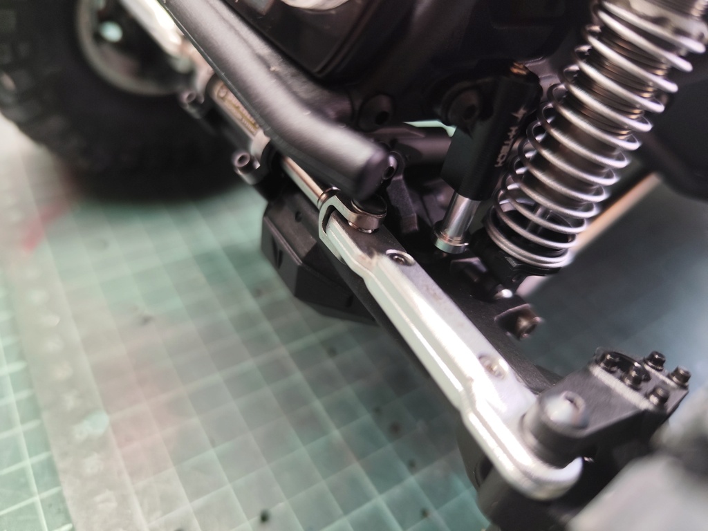

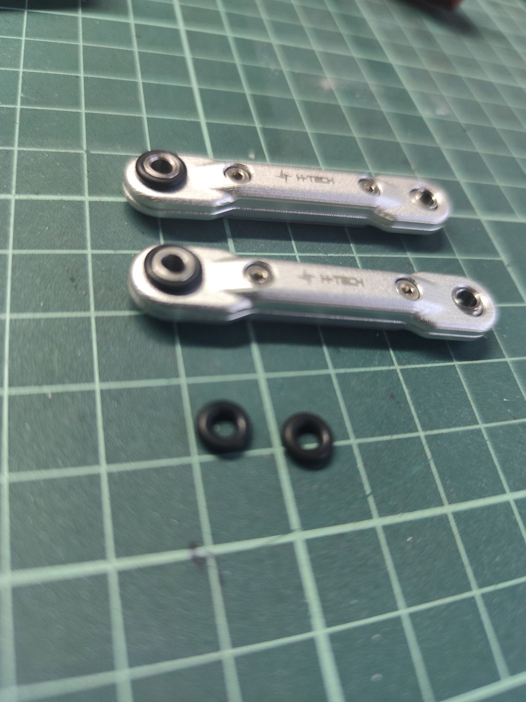

In the end I only mounted the bearing supports, the third aluminum member left a little slack and did not rotate as smoothly
To prevent the steering links from moving a little and thus prevent them from hitting the axle housing and getting stuck, some O rings in the balls of the links and problems solved
With all this, finally finished, now we have to try, I would also like to reduce the battle a little but I will try another time

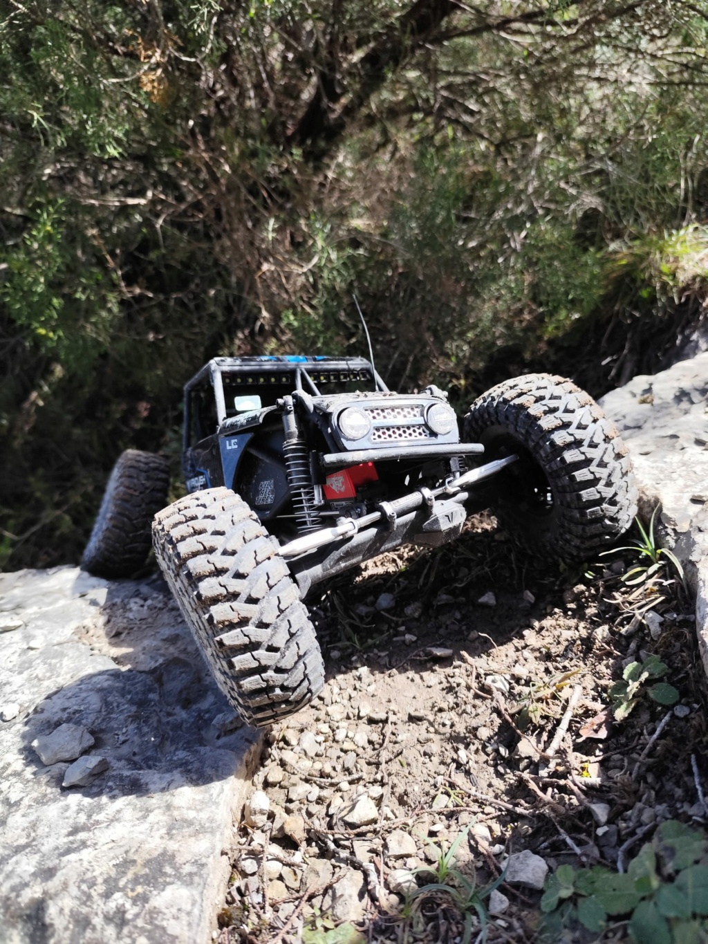

Released, for the moment I do not have more photos or videos, I was very entertained enjoying it

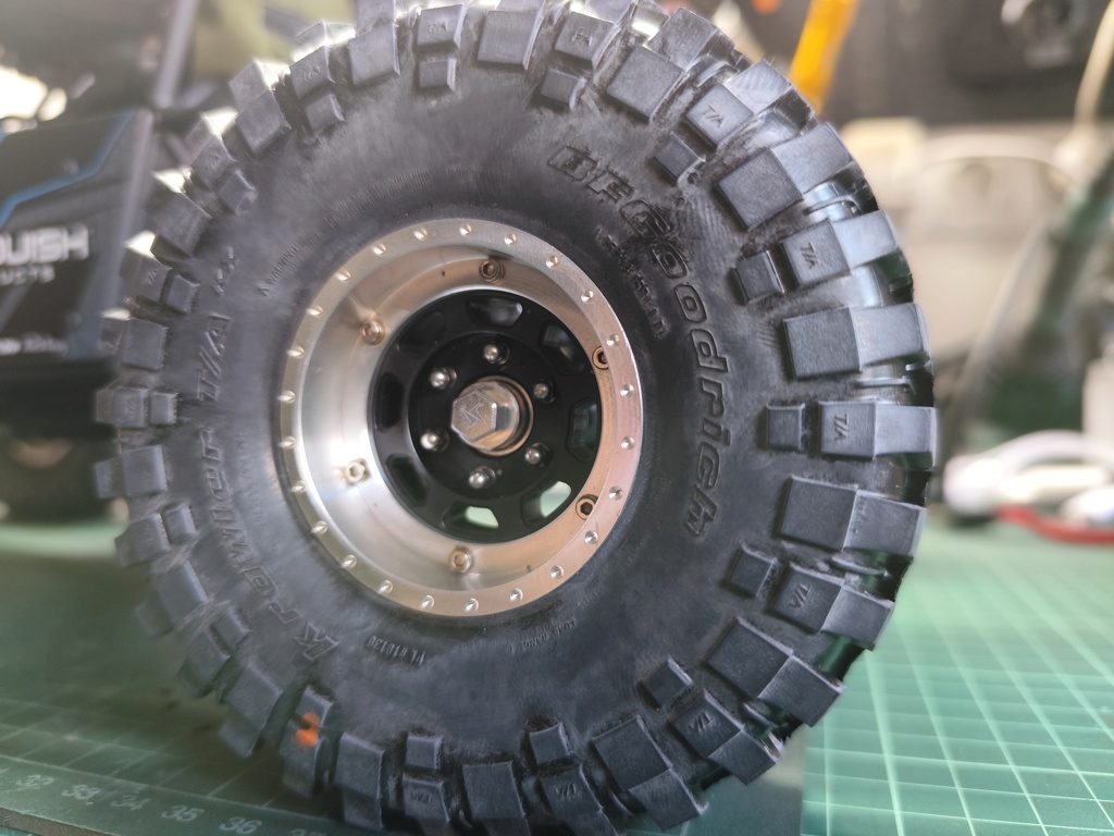

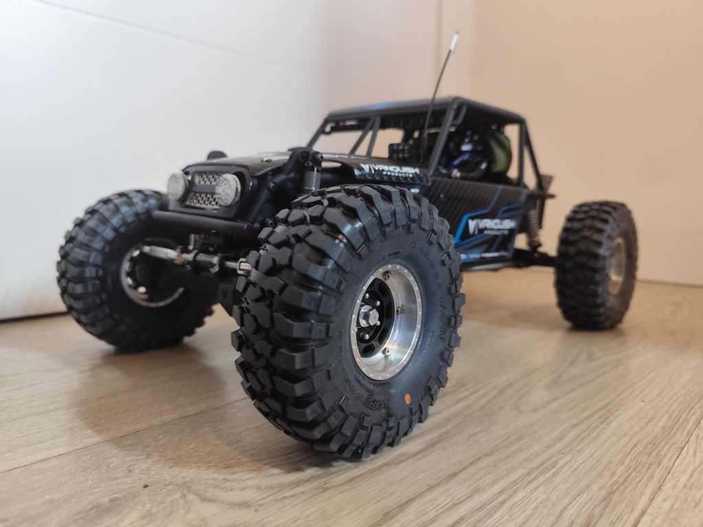

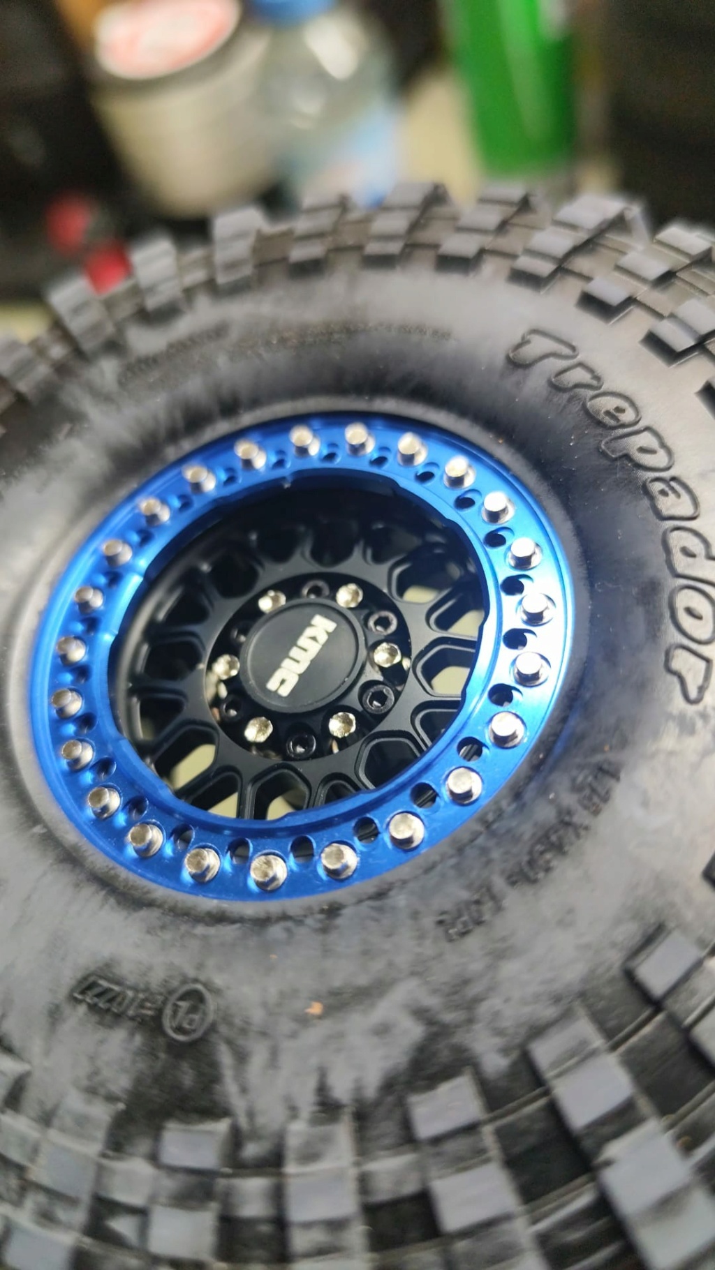

That aliexpress rims looks awesome

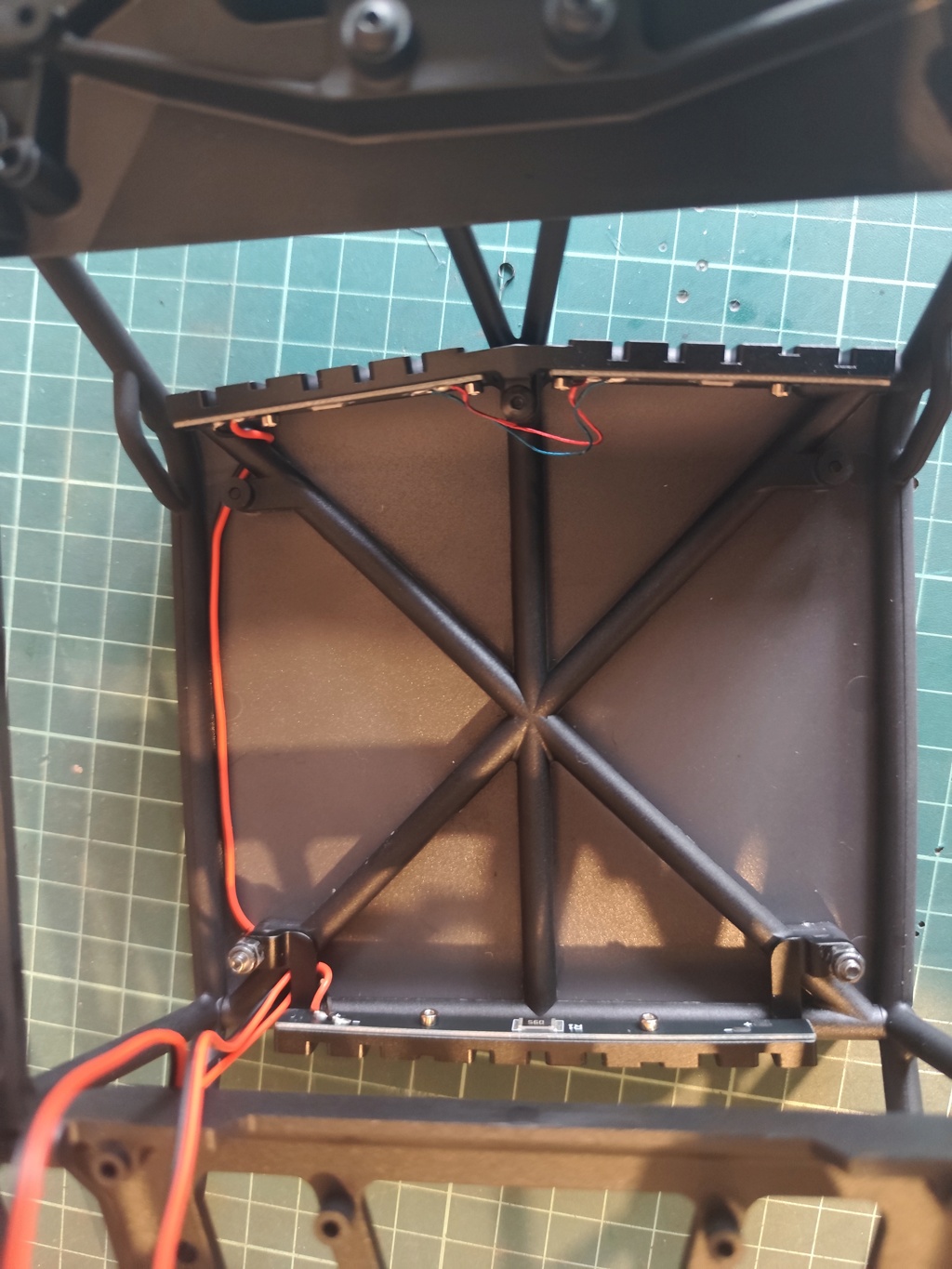

Bericht door FREEDOM83 » 23 jan 2025 08:44

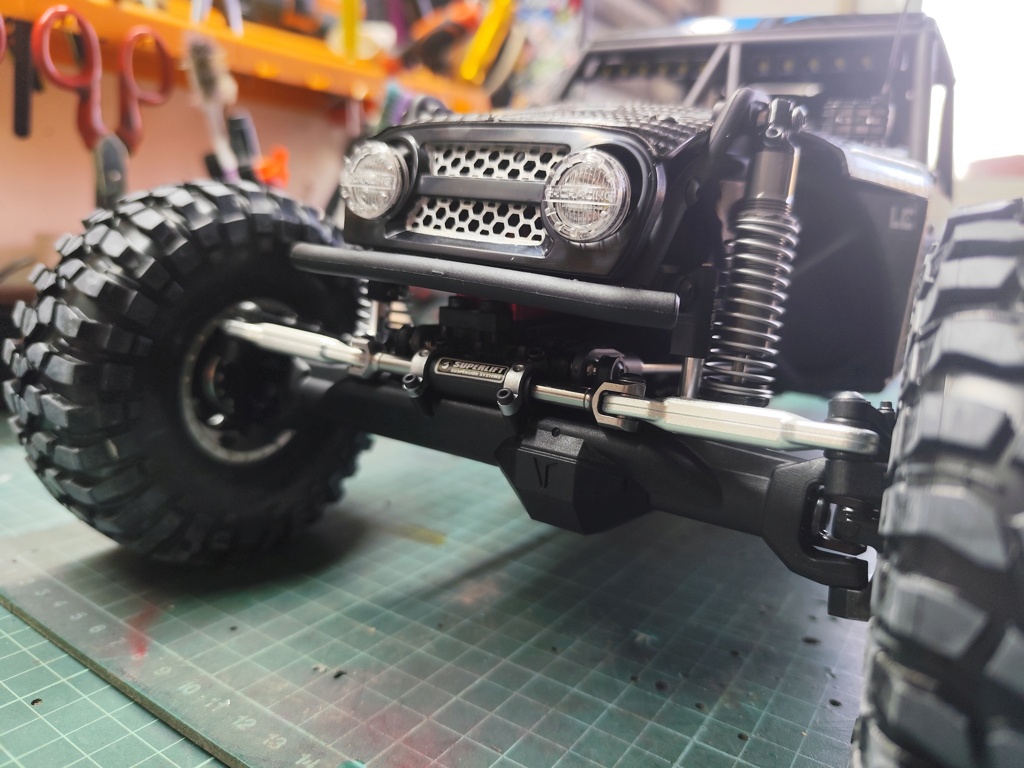

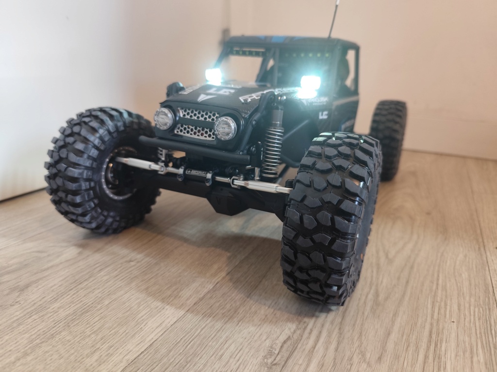

I CHANGED the center cover , dont like so much KMC cover , i think this looks better

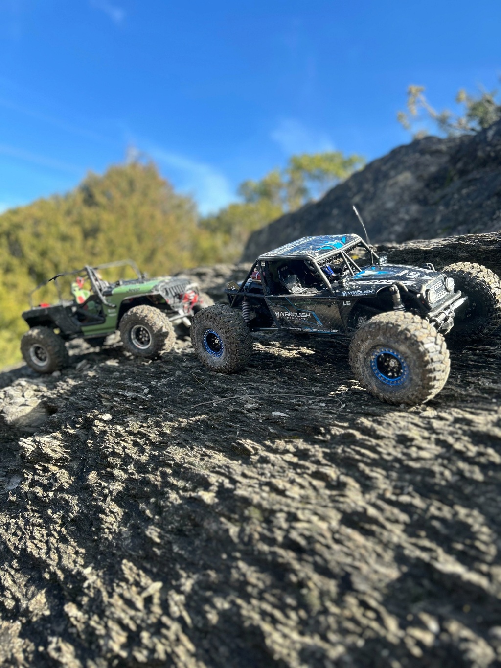

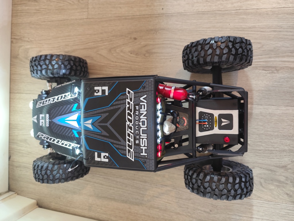

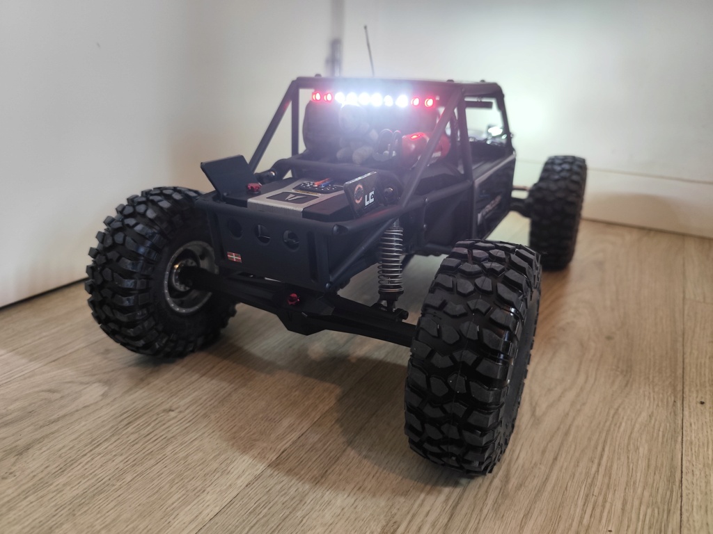

Bericht door FREEDOM83 » 17 feb 2025 10:38

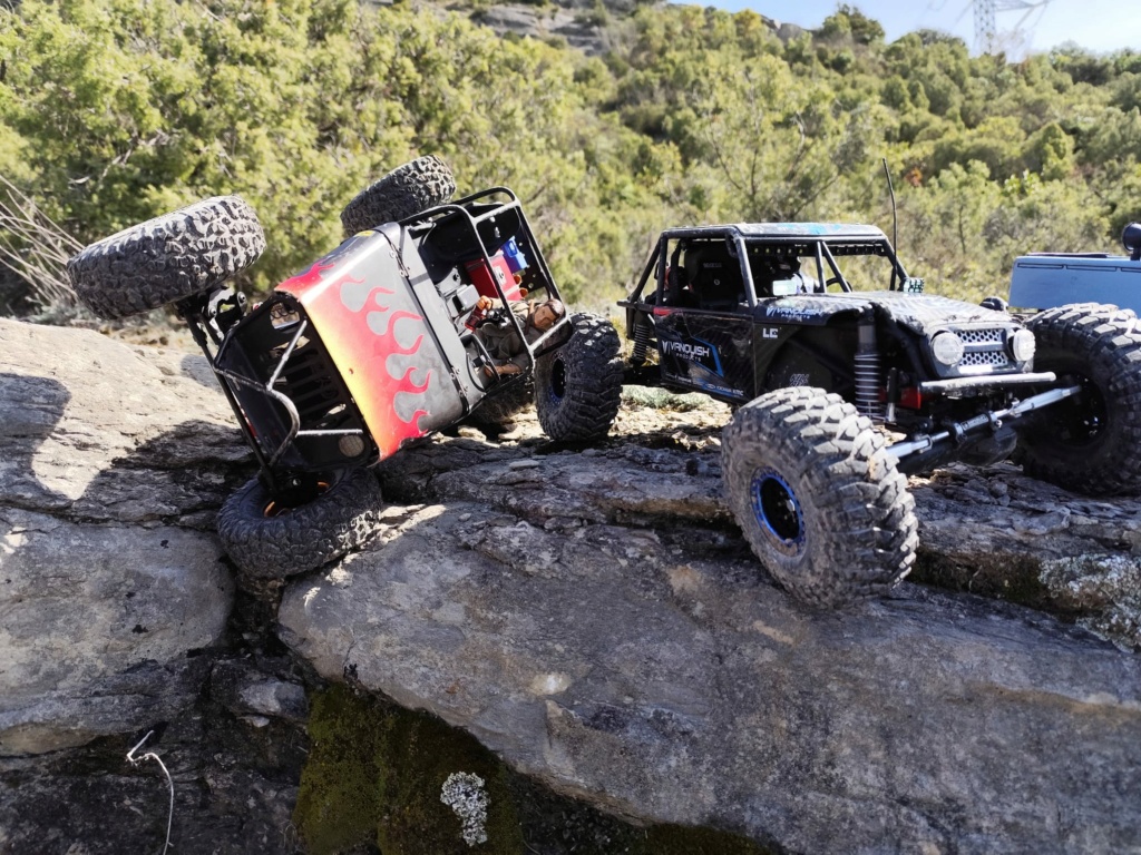

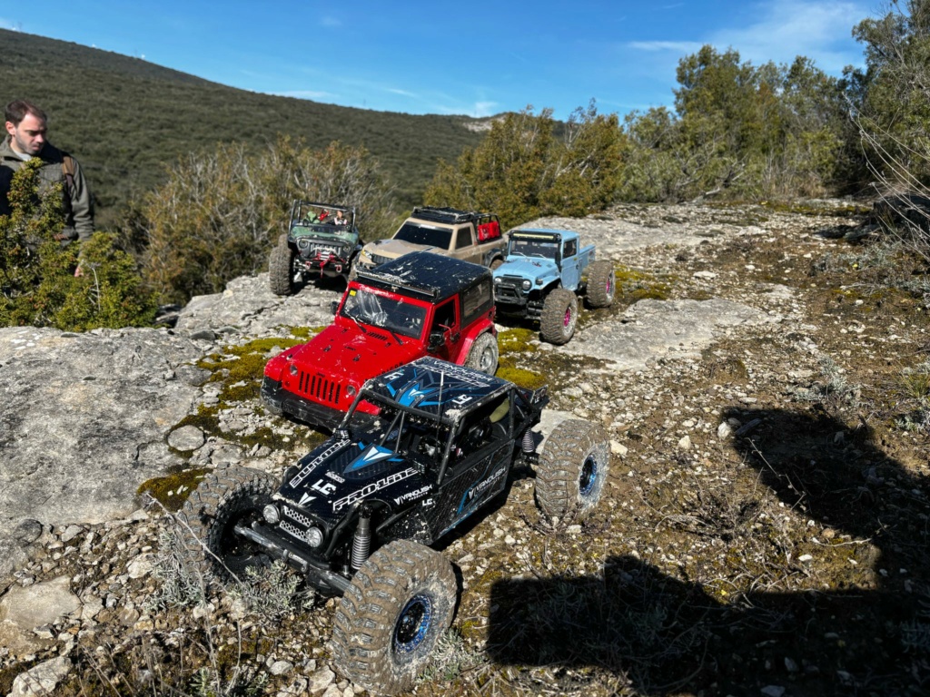

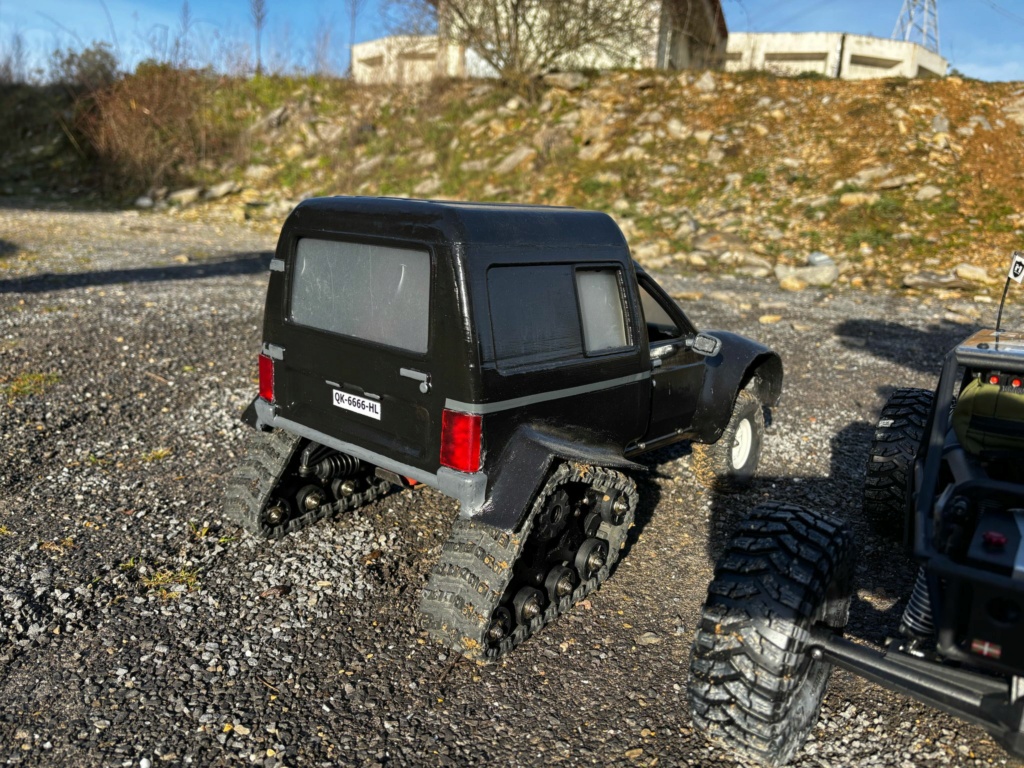

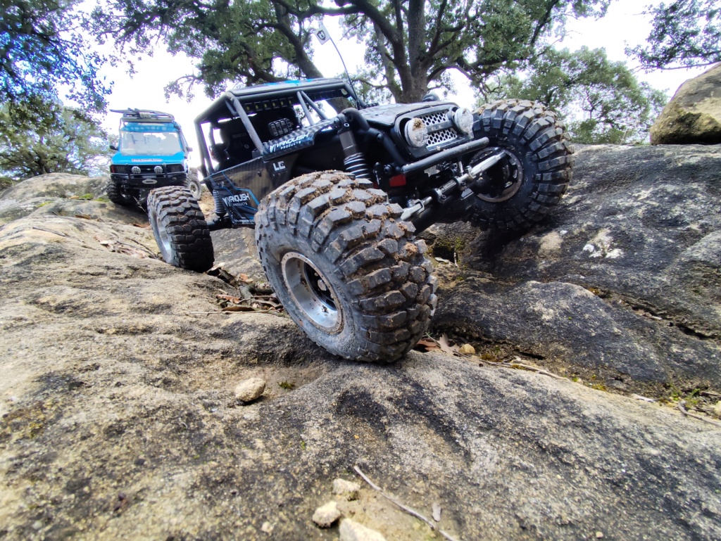

Some photos from Saturday and a friend's invention hahaha
